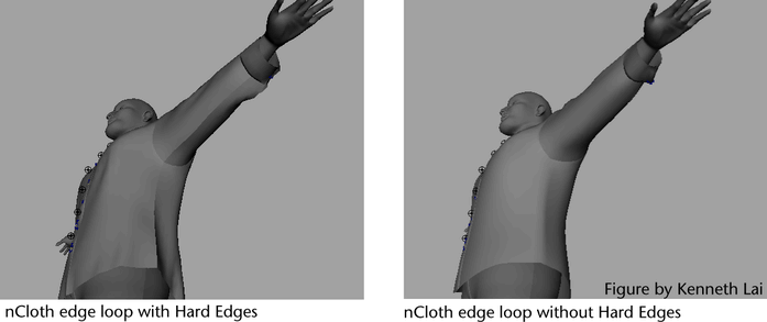

To create ridges on nCloth that resemble creases or seams
- Select the nCloth object (output mesh) on which you want to create a ridge to mimic a seam or crease.
- Select Edge component selection mode.
- Double-click one of the edges in the row of edges you want to crease.
All the edges in the row or loop are now selected.
- In the Polygons menu set, select Mesh Display > Harden Edge.
The edge loop you hardened is now a ridge that resembles a seam or crease on the nCloth object. This ridge retains its shape during its nCloth’s simulation.
