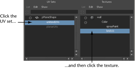

Assign a texture to a UV set.
Click the UV Set in the left column, then click the texture in the right column so it’s highlighted.

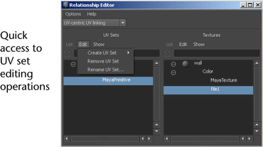

The Relationship Editor also provides easy access to several of the UV set editing operations in its Edit menu.
