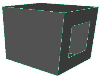

To make a hole in the shape of a second face
- Select .
In the Tool Settings dialog, optionally set the way in which the hole will interact with the faces. See Make Hole Tool Options.
- Click the face indicator in the center of the face where you want to make a hole.
- Click the face indicator in the center of the face that represents the shape of the hole.
- Press Enter to make the hole.

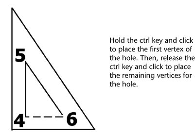

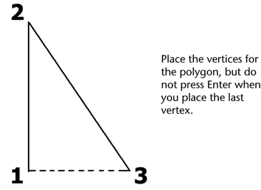

To create a hole in a polygon as you draw it
- Select .
- In the scene view, click to place the polygon vertices, but do not press Enter when you place the last polygon vertex. Instead, do the following:

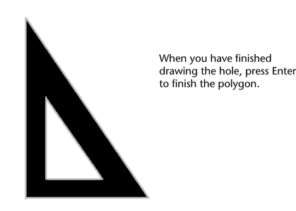

- Hold the Ctrl key and click to place the first vertex of the hole.
- Release the Ctrl key and click to place the remaining vertices for the hole.
- When you have finished drawing the hole, press Enter to finish the polygon.

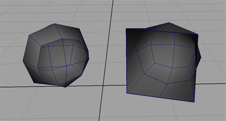

Unlike real holes in the geometry, you can still select and perform operations on invisible faces when in Face selection mode. If you subdivide the mesh (for example, using the Smooth operation), the subdivisions respect that the face is still there.
For example, the image below shows two cubes after being smoothed. The front face on the cube on the left was made invisible prior to the smoothing, while the same face on the cube on the right was deleted.
