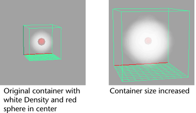

Changing container dimensions
The dimensions (physical size) of the fluid container are defined in the working units set for Maya. Increasing or decreasing the dimensions of a container while keeping the resolution unchanged increases or decreases the voxel size, respectively.
For example, if you increase the size of a container with Density, the total amount of fluid that appears increases proportionally and the fluid appears thicker than the original.

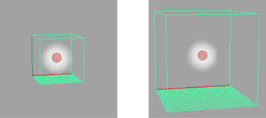

Scaling containers
Scaling fluid containers using the Scale transform increases the size of the container without scaling the properties inside the container.
For example, if you increase the scale of a container with Density, the density appears thinner because the amount of density in each voxel is redistributed to fill the larger voxel size.
