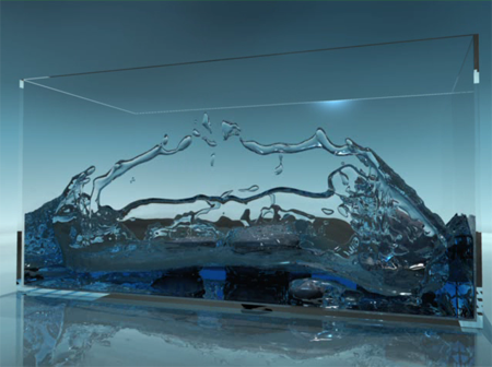

Liquid simulation setup
When Enable Liquid Simulation is on, you can use the Liquids attributes to create fluid simulations that look and behave like realistic liquids. Liquid simulations require a combination of Liquids attribute and other fluid attribute settings to create effects that have the physical characteristics of liquids.
The following sections provide attribute settings that are commonly used to create liquid simulations. The recommended settings are intended only as a starting point for your effect.
You can also import a fluid Liquids example file, which are included with Maya, or apply a liquid attribute preset as starting points to your liquid effect. See Import Fluid examples and Use fluid attribute presets.
