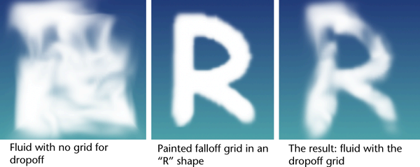

In the following images, the letter “R” is made using Fluid Effects and then it fades/simulates away like a cloud dispersing. Turbulence is used in the fluid volume to push it around. The falloff grid cuts out an “R” shape no matter where the density moves.

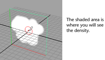

To paint falloff for Fluid Effects
  1. Select the Fluid Effects grid.
  2. Select Fluids > Add/Edit Contents > Paint Fluids Tool > .
    The Paint Fluids Tool settings window appears.
  3. Select Falloff from the Paintable Attributes drop-down list.
    Before painting, be sure to set the falloff display settings as in To display a falloff for Fluid Effects.
  4. Paint the fluids grid to create the falloff shape.

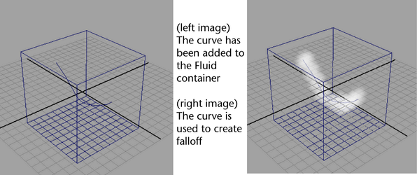

To use a curve within a container to create falloff for Fluid Effects
  1. Select the Fluid Effects grid and Shift-select the desired curve.
  2. Select Fluids > Add/Edit Contents > With Curve > > .
    The Set Fluids Contents With Curve Options window appears.
  3. Do the following:
    • Turn on the Density.
    • Turn on the Falloff.
    • Adjust the Falloff and Radius values.
    • Click Apply and Close.
    The curve now represents the falloff shape.
