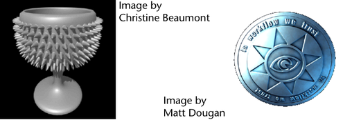

- Extra Sample Rate
This rate is used to take extra samples to refine the new vertices introduced during displacement mapping. Maya adjusts the vertices to align with the displacement.
For each tessellation triangle, notice how sharp the features are and how many curvy features there are. The sharper the features, the higher the Extra Sample Rate needs to be; adjust accordingly
Always try to set this value at 0 first if the result looks too jagged, then increase the value to get the results you need. The default value is 5. A value of 20 is usually enough.
In the following examples, the displaced surface on the left only needs an Extra Sample Rate value of 0, but the surface on the right needs an Extra Sample Rate of 5.
