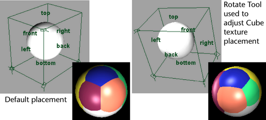

  2. Make the Env Cube’s texture placement object visible in the scene views and scale, rotate, translate it, or even animate the transformations.
    Reflections of the Env Cube are rendered as if the six images in the texture were mapped directly onto the six faces of the placement box.

To use the Cube’s texture placement object
  1. Use Maya’s transform tools with the Cube’s texture placement object to adjust the placement of the texture on the object. To see the results, IPR render the surface.
