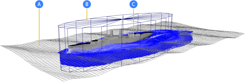

Elements of a guided simulation
- A. Guide mesh
The guide mesh defines the liquid surface, and the animation of its vertex positions provides the velocity input that guides the simulation. By controlling the deformation of the mesh, you can direct the surface waves artistically.
If the guide mesh has a color set named bifrostVelocity, the color set will be used as the guiding velocity input instead of the animated vertex positions. In particular, the mesh must have a bifrostVelocity color set if its topology changes (as might be the case with a cached geometry), because the velocity cannot be computed from the vertex positions when there is no correspondence between the vertices from one frame to the next. The RGB color channels correspond to the world-space XYZ velocity components in m/s, assuming that the scene has been modeled to a scale of 1 cm in Maya being 1 m in Bifrost.
For best results, the velocity should have both horizontal and vertical components. In addition, the waves in the guide mesh should move in a manner that's not too different from real waves. If the waves are extremely fast, slow, or big, then the simulation may have artifacts or produce other unexpected results.
In a typical workflow, you might also use the mesh for rendering the non-simulated regions of the liquid surface, and then blend between the simulated and non-simulated renderings during compositing.
As an alternative to using a mesh as a guide, you can use a low-resolution simulation to guide a high-resolution one — see Guide a Bifrost liquid with a low-resolution simulation.
- B. Emission region
Emission regions define the volume in which liquid is emitted. Limiting the emission in this way saves memory and computation time.
As an alternative to using a separate mesh to define an emission region as illustrated, you can use the same meshes that are being used as colliders, and specify the thickness of an emission region around them.
The emission regions can be both animated and deforming. As the regions move, new particles are seeded in formerly empty areas, and particles outside the regions die after a time interval that you can set.
The emission regions should not extend horizontally beyond the guide meshes.
- C. Collider
The liquid interacts with colliders such as boats and rocks, creating effects such as splashes, wakes, and bow waves.
