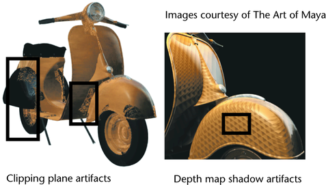

Reduce artifacts and flicker
For Maya software renderer only.
Artifacts can show up as unintentional blotches, bands or cross-hatches on surfaces. Textures can flicker or crawl on surfaces from frame to frame during animations.
Unlike anti-aliasing techniques, you cannot adjust the settings in the Render Settings window to reduce artifacts and flicker. Instead, you can fix shadow artifacts, clipping plane artifacts, or animation flicker independently.
Shadow artifacts
Raytraced shadows are susceptible to the terminator effect, a self-shadowing error that results from tessellation (triangles that approximate a smooth surface). To fix raytraced shadow artifacts, increase the tessellation.
For more information on tessellation, see Introduction to Tessellation and Approximation.
Clipping plane artifacts
Clipping planes help Maya to determine how far and near objects are relative to the camera. By default, cameras have Auto Render Clip Plane turned on so that Maya can sort geometry as accurately as possible. If objects seem to inter-penetrate each other, turn off Auto Render Clip Plane and set the Near Clip Plane to 1.0.
Especially in large scenes that have objects close together, background surfaces may appear to show through nearby surfaces. This is a result of how the camera’s clipping planes determine the depth position of geometry; the problem results from the limited precision used to store depth information. It is mainly influenced by the following camera parameters: near clip distance, far clip distance, and camera angle.
For more information on clipping planes and these settings, see Clipping planes.
