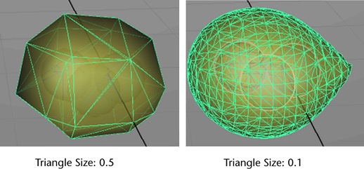

- Set the Mesh Triangle Size to specify the size of the polygon triangles that are used to create the nParticle output mesh.
Smaller Triangle Size polygons produce smoother meshes, but take more time to simulate.
