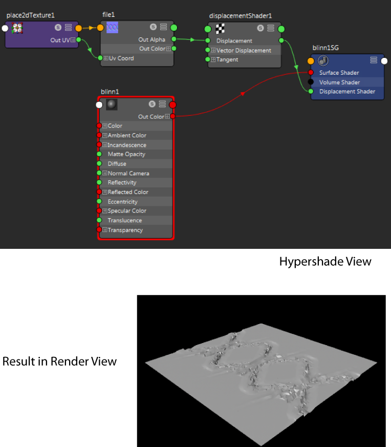

To create a displacement map
  1. In the Hypershade window, drag and drop the desired material, for example, a Blinn, to the work area to create it, and middle-drag the material swatch onto the object in the viewport to assign it.
  2. Select the shading group node. In the shading group Attribute Editor, click the map button beside the Displacement mat attribute and assign it a new file node.
  3. In the file tab, assign the desired image file.
  4. Click the Render the current frame button to see the render results.
    Tip: By default, displacement map results do not display in the viewport. To preview the results, see Preview the displacement results.
    You can also use Modify > Convert > Displacement to Polygons to bake the displacement into the actual polygon geometry.
