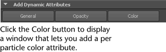

- Select the emitted particles and add a per particle color attribute (rgbPP) from the Add Dynamic Attributes section of the Attribute Editor.

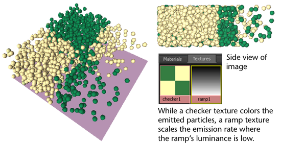

When Emit From Dark is off, fully luminous parts of the texture emit at 100% of the specified emitter rate. Parts of the texture that lack luminance don’t emit at all. Other parts emit between 0 and 100% in proportion to the luminance. In simple terms, bright colors emit more than dark colors.
When Emit From Dark is turned on, the opposite luminance scheme applies. Parts of the texture that lack luminance emit at 100% of the specified rate, while fully luminous parts don’t emit at all.
Tip: To emit at distinctly different rates from parts of the surface, use a texture with sharp contrast in luminance. For instance, use a striped black and white texture.If you see a few particles emitted from a seemingly wrong position of the texture, check that the coloring in that area has consistent luminance.
You can figure the exact luminance value of a color by adding its RGB components and dividing by 3. For instance, the luminance of RGB value 1, 0, 0 equals 1/3, or 0.33. The luminance of RGB value 0, 0, 1 also equals 1/3, or 0.33. In other words, a saturated red has the same luminance as a saturated blue.
- Rewind and play the scene to see the texture-scaled emission rate.
