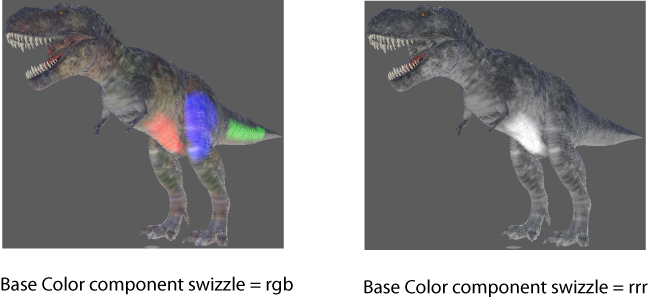

The following example demonstrates the different effects when the Base Color input is xyz (rgb) versus when the Base Color input is rrr.

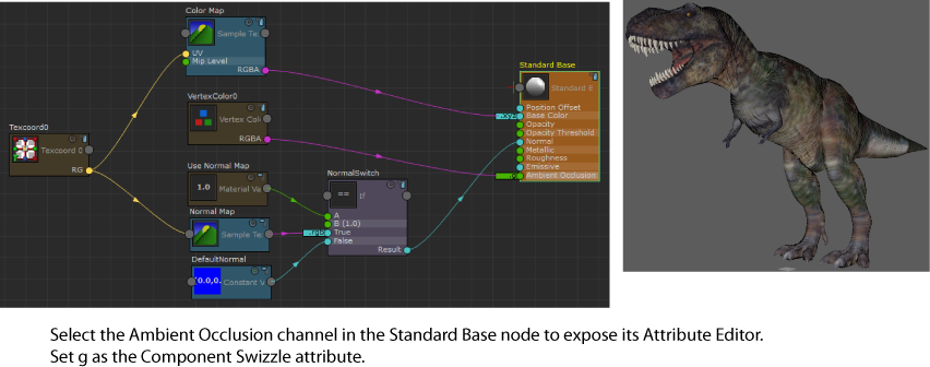

Example: Connect your vertex color green channel to Ambient Occlusion
  1. Connect the RGBA output of your Color Map to the Base Color input of Standard Base.
    Your color map will provide the base color for your model.
  2. Connect the RGBA output of your vertex color to the Ambient Occlusion input of Standard Base.
    The float3 output is converted to float automatically and the r channel is used by default.
  3. Select the Ambient Occlusion channel in the Standard Base node, and in the Attribute Editor, enter g in the Component Swizzle attribute.
In this example, you can see the ambient occlusion on parts of the dinosaur's tail where it was painted green.
The r and b channels of vertex color can now be connected to other inputs; for example, r for Metallic and b for Roughness.
