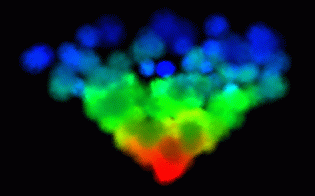

- Play the scene back and render.
You’ll see the particle color textured by the ramp as the particles age.

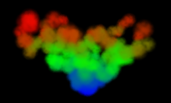

- Turn on
Inverse Out Uv and re-render.
The colors are reversed—instead of the particles changing from red to green to blue, they change from blue to green to red.

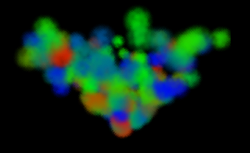

- Click place2DTexture1.
- Set
Noise UV to 1.0 and 1.0 and re-render.
Noise is applied to the placement of the ramp creating randomness in the red, green, and blue particles.

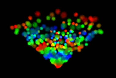

- Change the Out Uv Type to Absolute Age and set a normalization value of 1.
- Rewind, play about 100 frames, and render.
Notice that the particles cycle through the ramp more than once as they age.
