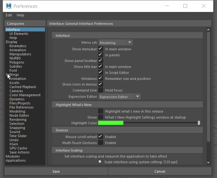

To change Maya's default unit of measurement
  1. In the Maya menu bar, go to Windows>Settings/Preferences > Preferences.
  2. In the Settings category, locate Working Units.
  3. In the Linear drop-down menu, select your preferred working unit.
