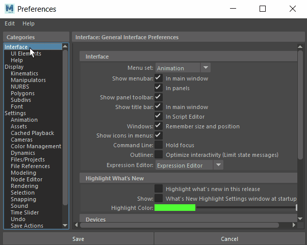

In the
Preferences window you can set preferences for many functional elements of
Maya, organized by different categories.
Open the Preferences window and click the categories on the left side to show the settings.
You can also click the Animation Preferences icon
in the lower-right corner of the
Maya window. This opens the
Preferences window to the
Time Slider category, but you can then select any category you like.
