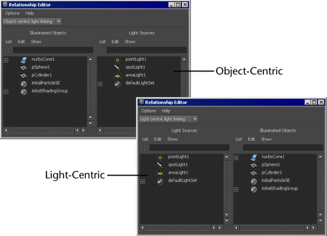

Selecting a light linking option opens the Relationship Editor in either Light-Centric or Object-Centric mode.
Note: Linking single objects to single lights is the preferred method of light linking.
To create a light set
- In the Relationship Editor, select Light Centric Light Linking.
- In the left panel (Light Sources), select the lights you want to include in a new set and select
Maya adds a new light set to the bottom of the light list.
To create an object set
- In the Relationship Editor, select Object Centric Light Linking.
- In the left panel (Illuminated Objects), select the objects you want to include in a new set and select
Maya adds a new object set to the bottom of the object list.
To add or remove an object or light from a set
- In the Relationship Editor, select Set Editing from the drop-down menu.
- In the left panel (Sets), select the set.
The objects (or lights) in the set are highlighted in the right panel.
- In the right panel (Objects), select the objects (or lights) you want to add to the set and clear the selection of objects (or lights) you want to remove from the set.
