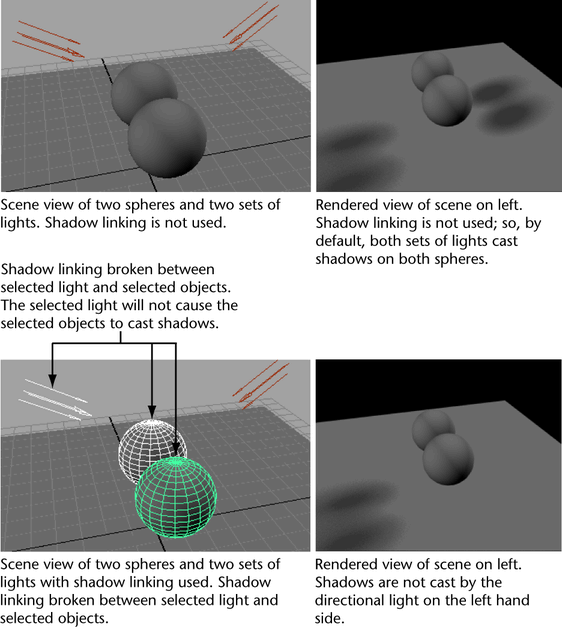

Use shadow linking to link light sources with surfaces so that selected objects only cast shadows from light sources with which they are linked. This technique is similar to light linking except that it controls shadow calculations rather than illumination calculations.

- The shadows in your scene can obey only one of light linking or shadow linking and not both. Therefore, for the purpose of shadows, you must decide whether to incorporate light linking or shadow linking in your scene.
- The Shadows Ignore Linking option is available via the Render Settings window. This option specifies that all objects are shadow casters and any light or shadow links are ignored for shadow calculations. See Shadow linking for more information.

To break links between lights and surfaces using shadow linking (if rendering with Maya Software renderer)
- Select the lights and surfaces you want to link.
- In the Rendering menu set, select Lighting/shading > Break Shadow Links.
