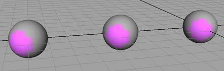

To create shared Color Per Vertex data per instance
  1. Select one of the instances.
  2. Select Mesh Display > Color Set Editor.
    The Color Set Editor appears. See Color Set Editor Options.
  3. In the Color Set Editor, click New.
    The Create Empty Color Set Options window appears. See Create Empty Color Set Options.
  4. Set Color Set Sharing to Per Instance Shared.
  5. Click Apply and Close.
  6. Color vertices on the instance with either Mesh Display > Apply Color or Mesh Display > Paint Vertex Color Tool.
    The painted colors appear on all instances of the object (including the source).

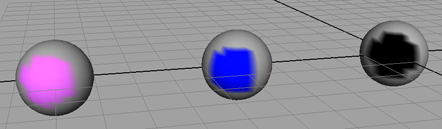

To create unshared Color Per Vertex data per instance
  4. Set Color Set Sharing to Per Instance Unshared.
  7. Select another instance of the object you want colored differently and repeat steps 3-6.
    Each instance you create a new unshared color set for, is colored differently. If you rename one of these unshared color sets, the corresponding unshared color sets on other instances are renamed accordingly.
    Note: It is recommended that you rename unshared color sets since they can become very difficult to manage with default names.
