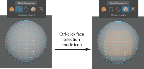

    In the following example, vertices are converted to faces.
