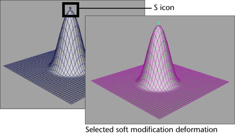

  1. In the scene view, select the S icon for the soft modification deformation for which you want to adjust the falloff.

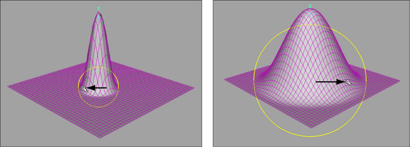

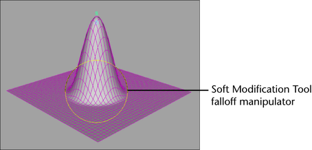

  3. Press b to display the falloff manipulator, then b+drag to adjust the manipulator size.
    The manipulator changes size as you drag, adjusting the falloff radius and influence area of the soft modification deformation.
