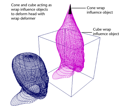

A wrap influence object is a NURBS or polygonal object being used by a wrap deformer (the wrap deformer algorithm node) to deform an object. The shape and the transformations of the wrap influence objects and their points provide the shape of the deformation.
When you create a wrap influence object, Maya makes a copy of the influence object and uses it as a base shape for the deformation. Any difference in position, orientation, or shape between the base shape and the wrap influence object results in a deformation of the surface being influenced by the wrap deformer.
A wrap deformer can include one or more influence objects. You’ll often use several wrap influence objects to create deformation effects based on the competing influences of the objects.
