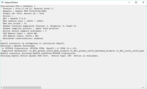

Output Window
The Output Window is an additional console that runs alongside Maya in Windows to give various diagnostic and status updates (specifically, stdout and stderr output). When performing certain calculation-heavy operations, Maya may send progress updates to the console instead of the main user interface. So if your interface appears to be frozen, check the Output Window to see if updates are being sent there instead.
You can open the Output Window via Windows > Output Window. You can also show/hide it with the outputWindow command.
