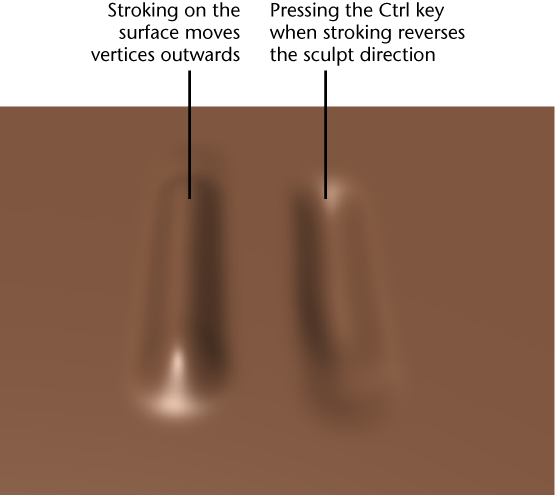

- Click-drag the tool cursor across the surface of the mesh(es).
The vertices on the mesh(es) move slightly outwards along the path you dragged. This path is called a stroke. A stroke appears continuous but is actually made up of many stamp impressions that overlap each other. You can adjust how much the stamps overlap by adjusting the Spacing setting.
Note: Not all sculpting tools move vertices outwards by default. - To reverse the sculpt direction for any sculpting tool, Ctrl-drag the cursor across the surface of the model.
