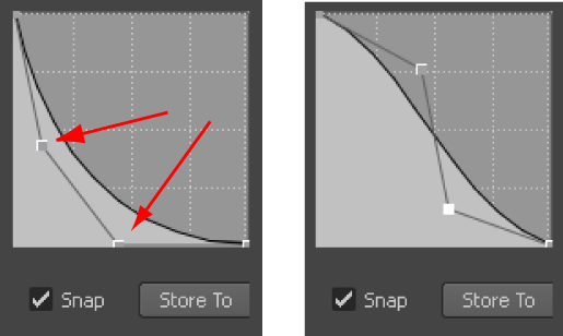

Tool Settings, use the curve image to add, delete, and drag curve points to adjust the shape of the curve:
Tip: For an expanded view of the curve, click
next to the falloff curve image to open a larger
Falloff Curve editing window.
- To move points, drag them.
- To insert new curve points, click anywhere on the curve when the cursor displays an add symbol
- To delete points, click the corresponding delete handle
at the bottom of the curve view, or Ctrl-click points directly. (The cursor displays with a red x
when deleting points.)
To help you distinguish between points that are close together on the curve, the delete handles display in shades of grey. The darker the delete handle, the higher the point on the Y-axis.
