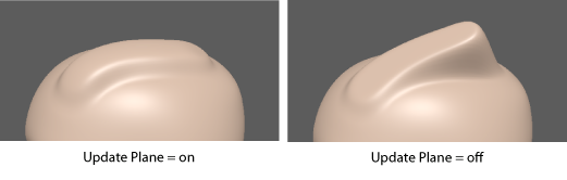

Update Plane
Specific to the Flatten, Wax, Scrape, Fill, and Amplify tools. Recalculates the underlying tool plane for each stamp update in a stroke. When on (default), the tool adheres to the curvature of the sculpted surface. When off, the underlying plane is determined by the initial stamp and remains fixed for the duration of the stroke.
Whole Stroke
Specific to the Flatten, Wax, Scrape, Fill, and Amplify tools. Continuously recalculates the underlying tool plane for each vertex affected during a stroke, creating a more planar effect throughout the stroke.
Whole Stroke is only available when Update Plane is on.
