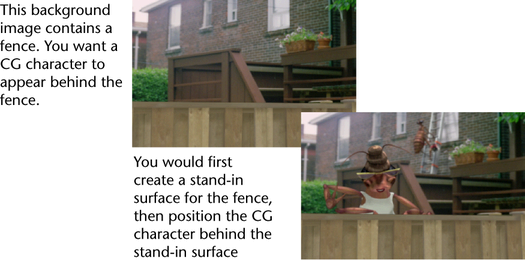

3D background simulations
An image file background is a 2D image that exists behind the objects in the scene. You can, however, simulate a 3D background by creating “stand-in” surfaces that represent objects in the background image. An object in the scene can then:
- move behind an object in the background image.
- cast shadows onto objects in the background image.
- receive shadows from objects in the background image.
- be accurately reflected by the objects in the background image.
