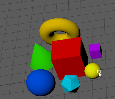

When you group objects together, you can select, move, rotate, and scale the group as a single unit.
Press Ctrl + G to group objects together

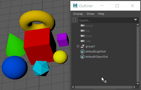

Select object inside a group. |
Open the Outliner and expand the group node to show the objects inside the group, then click the object you want to select. ![]() |
In terms of the scene hierarchy, the Group command moves the selected objects under a new transformation node.
