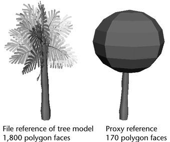

A scene contains a file reference to a scene containing a tree model. The referenced tree will be substituted with a simpler proxy reference.

Maya updates the file reference by loading the treeSimple proxy reference (tagged loRes) into the scene.
