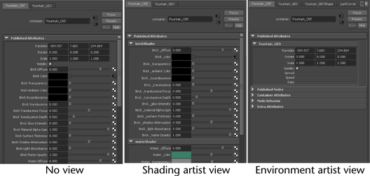

The following illustration shows the Attribute Editor for a fountain asset first with no views assigned, then with two different views created for the shading artist and the environment artist on a team. Each artist is supplied with only those attributes they will need when working with the fountain asset.

Template views
Template views let you define the way an asset’s published attributes are displayed in Maya windows and editors. Depending on your production requirements, you can create multiple views for each template. (See Add a view to an asset template)
A template view is essentially a set of published asset attributes that you have grouped and organized together for a specific purpose. Creating a set of different views for one template lets you create a different user interface for any purpose your pipeline requires. (See Customize a template view.)

  • Customize the basic display of asset attributes in the Outliner, Attribute Editor, Asset Editor and Channel Box.
    Re-organize the asset display, changing the grouping and order of attributes.
  • Control which attributes can be viewed and modified by each member of your team.
    You can specify the attributes you want each user to have access to by creating a template view for that user. For example, you might create a view for the modeler, one for the rigger, and one for the animator on your team.
    You group the controls and attributes that each user needs into an interface designed specifically for them. Since each user can modify only the attributes you have included for them, there is no danger of team members accidentally overwriting attributes not related to their work.
