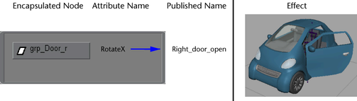

Published attributes
Publishing a node attribute to an asset makes that attribute visible at the asset level. A published attribute consists of three parts:
  • An internal node attribute.
  • A published name on the asset.
  • A relationship connection from the internal node attribute to the published name.
You can modify published attributes as though you were modifying the values of the corresponding encapsulated attributes directly. This allows you to:

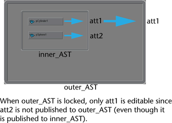

You can publish published attributes from a child asset to a parent asset. This allows you to build asset hierarchies to better manage your scenes.
For example, in a car scene you may create an asset for the front wheels named front_wheel_AST that is encapsulated by the asset for the entire car named car_AST. You can then publish the wheels’ rotation first to front_wheel_AST and then publish those published attributes to car_AST.

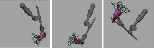

Maya handles published node parent relationships differently compared to other relationships during file input and output. Rather than using the node’s name directly, parent anchors and child anchors rely on the published name of the parent/child to manage the relationship between objects. This is especially useful when working with file referencing.

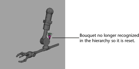

For example, suppose you reference a file with a bouquet and parent it to an arm in the parent file.
If you alter the hierarchy or name of the bouquet file, Maya is unable to maintain the relationship between the arm and the bouquet in the parent file since the DAG path has changed. as a result the bouquet loses all its relationship data and is reset to the origin.
You can avoid this problem by encapsulating the bouquet in an asset and publishing bouquet_GRP as a child anchor. Then you can change the names and structure of the bouquet without affecting the relationship to the arm.
