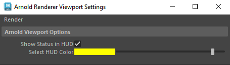

It is possible to render inside the Maya viewport, by switching the viewport "Renderer" to Arnold. Some of the Arnold RenderView options are exposed in the viewport as follows:
- Start/stop Arnold in the viewport.
- Define a crop window.
- Set the viewport render resolution.
- Set shading to debug mode.
- Select display channels (AOVs).
