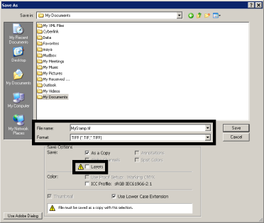

  5. Save the image by selecting File > Save As.
  6. In the Save As window, specify a filename for the image, set the following items, then click Save.
    • Format: TIFF
    • Layers: Off

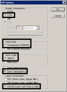

  7. In the TIFF Options window that appears, set the following, then click OK.
    • Image Compression: LZW
    • Pixel Order: Interleaved (RGBRGB)
    • Byte Order: IBM PC
    • Save Transparency: On
    • Layer Compression: Discard Layers and Save a Copy
