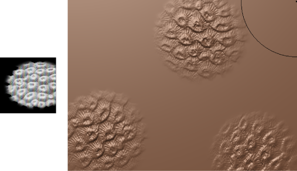

Change a stamp's impression
You can configure your stamp so that it makes a deeper imprint on a surface with the Stamp Offset property.
The default value is 0.00, which means that black areas of the stamp image make no surface impression, and the deformation strength increases until it reaches white.
A Stamp Offset value of 0.50 means that black areas of the stamp image indent the model's surface with -50% deformation, continuing until it reaches a +50% elevation in the white areas.
Comparison: Stamp Offset default versus 0.50 setting
