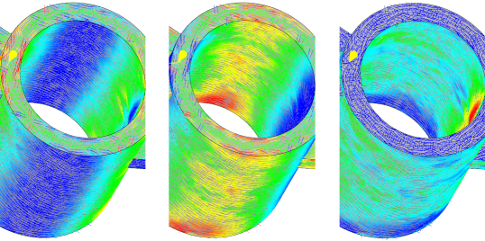

Figure 1 Intermediate fiber orientation tensor over time
Figure 1 shows the increase and then decrease of blue (low probability) tensors which illustrates how the fiber orientation tensor result changes through the injection cycle.

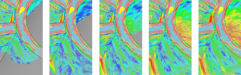

Midplane and Dual Domain analyses can also show the fiber orientation tensor at different positions through the thickness of the part at intermediate times if the profiled results output has also been enabled. A 3D analysis can only be displayed on the surface or cutting plane.
Figure 2 Intermediate fiber orientation through thickness
Figure 2 shows, from left to right, the fiber orientation tensor from the middle of the part to the surface for a Dual Domain analysis.

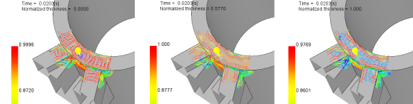

Principal direction
The direction in which most fibers align is the called the first principal direction. A value close to 1 indicates a high probability that the fiber alignment is in this direction. The first principal direction may be close to, but may not necessarily coincide with, the material flow direction.
Figure 3 Intermediate fiber orientation result in the principal direction
The second and third principal directions are based on, and are at right angles to, the first principal direction. Their values also indicate the probability of fiber alignment in their respective direction.
As this is a probability result, the sum of the probability for all three principal directions equals 1.
