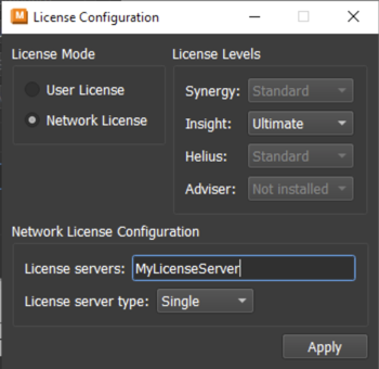

The License Configuration tool can be accessed from the Windows Start menu, located in the Autodesk Moldflow Insight folder.
Network License configuration
Make sure that you have the following information at hand for the Network license configuration:
  1. Your Network license tier Subscription
  2. The Name (or IP address) for your Network license server
  3. Your License server type (Single, Redundant or Distributed)
To activate the Network License
  1. Select the Network License in the License Mode section.
  2. Choose the License level depending on your purchased license.
  3. In the Network License Configuration section, enter the license server name (or IP address)
  4. Define the license server type. Options include Single, Redundant, and Distributed.
  5. Click Apply to accept the settings and close the dialog.
Note: Take care when entering the server name and license level - the License Configuration tool does not check for errors.
