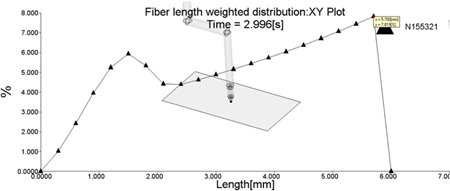

Fiber length weighted distribution result
The Fiber length weighted distribution result shows the distribution of fibers, weighted according to their length.

Using this result
For Dual Domain and Midplane models, the averaged distribution of fiber length through the thickness is shown. This is a time series result and so the fiber length changes can be shown through out time.
For 3D models, it is the distribution of fiber length at each node. This result can specify a node to have this result plotted against. This plot is only shown at the last time step.
To add the Fiber length weighted distribution result to the display, click
(Results tab > Plots panel > New Plot). On the Result Selection tab, select Fiber length weighted distribution from the list of available results, and select XY plot type to display.
