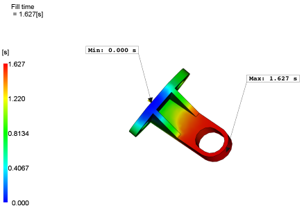

When interpreting the results, it is often valuable to identify the extreme values of the results and their location. The Show Min/Max tool locates the maximum and minimum data points on the geometry, and labels them with the result value.
You can also move the Min and Max labels for flexible usage.
