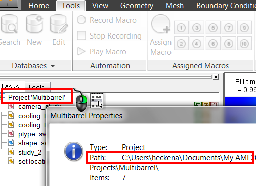

To view sub barrel logs again
After you run the vbs script, the sub barrel logs are written to text files that are saved in the project folder.
Right-click on your project name and select Properties in the drop-down menu, to determine the project location.
Navigate to your project file and scroll down the list to the text files.
