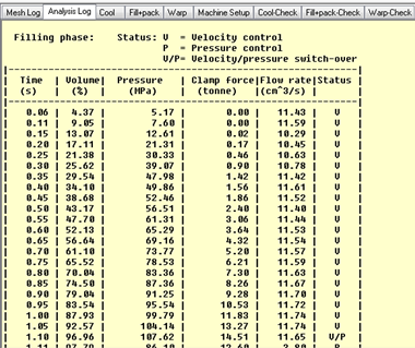

Analysis progress table
This section includes an analysis progress table, which provides tabular results for each time-step in the analysis. During the filling phase you can see the relation of volume of cavity filled, pressure inside the cavity, clamp force, and flow rate to analysis times. During the packing phase the percent of cavity packed over time is reported.
