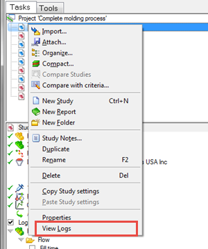

In order to improve the workflow, and save time, particularly with large models, you can view the study log of a study in an open project, without opening the study. There are different ways to access the analysis logs without having to open the study file:
In the project tree, hover over the study of interest, then click the right mouse button and select View Logs from the drop-down menu
Open the Job Viewer (
(Home tab > Analysis panel > Job Manager), select a study in the Studies list, then click View Logs at the end of the row.
In either case, the study log opens in a new window.
