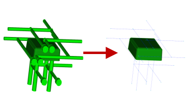

Manually modelling cooling channels is a lengthy task for even relatively simple cooling systems. The center line extraction tool simplifies the process.
You can now quickly extract the center line curves from cooling channels that have been imported as 3D CAD bodies, as the first step towards generating cooling channel beam elements.
After you assign the property Channel (3D) to the relevant 3D CAD bodies, center line curves are extracted with a few additional mouse clicks.
The channel diameter of the 3D CAD body is automatically assigned to each curve as it is generated.
