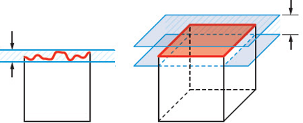

Flatness
Flatness measures the minimum distance between two parallel planes, that straddles all the selected points. The two parallel planes may not be parallel to any surfaces in the original geometry, nor to any coordinate axes. The orientations of the planes are determined by minimizing the sum of squared errors to find the plane which best fits all the selected nodes. Flatness does not report the deflection from any original geometry.
Select a single node on the surface of interest, and all nodes on that surface are automatically selected, if you have Auto select surface enabled.

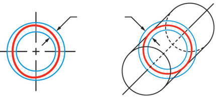

Roundness
Roundness describes the maximum total deviation of the selected nodes from a best-fit circle. The maximum total deviation is the sum of the largest positive and largest negative deviation from the circle radius. The best-fit circle may not align with any features in the original geometry, nor to any coordinate axes. Roundness does not report the deviation from any original geometry.
Select a node on a rounded edge, and all nodes on that edge are automatically selected, if you have Auto select surface enabled.
