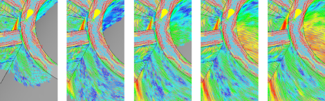

The Intermediate fiber orientation tensor result shows the probability of fibers aligning in a specified direction over time.
Fig 1: Intermediate fiber orientation tensor over time
Figure 1 shows the increase and then decrease of blue (low probability) tensors. This illustrates how the fiber orientation tensor result changes through the injection cycle.

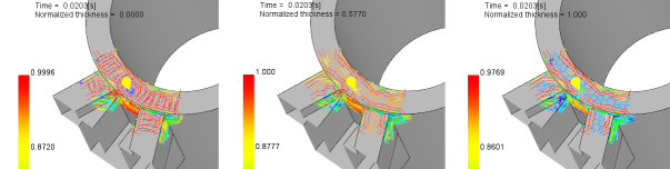

Midplane and Dual Domain analyses can also show the fiber orientation tensor at different positions through the thickness of the part at intermediate times if the profiled results output has also been enabled. A 3D result can only be displayed on the surface or a cutting plane.
Fig 2: Intermediate fiber orientation tensor through thickness

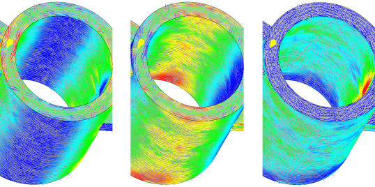

By default, the tensors are shown in their principal direction - the direction in which most fibers align. The tensor components can also be displayed in relation to a Global Co-ordinate system or a user defined Local Co-ordinate system.
Fig 3: Intermediate fiber orientation tensor in the principal direction
Fig 4: Intermediate fiber orientation for the same result, but in the Txx, Tyy, Tzz orientations for the Global Co-ordinate system
