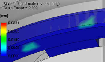

Sink marks estimate (overmolding) result
The Sink marks estimate (overmolding) result displays the calculated depths of sink marks in the overmolded component, and shows a legend to detail the depth differences.

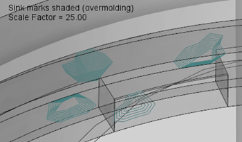

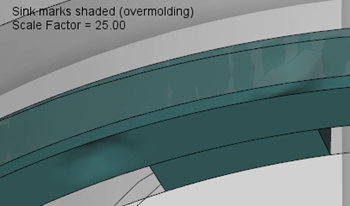

Sink marks shaded (overmolding) result
The Sink marks shaded (overmolding) result displays the sink marks in the part as lines and marks, more indicative of the actual appearance.
Change to contours to see the marks more clearly.
