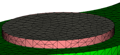

The existing preconditioning analysis for compression molding was developed for microchip encapsulation in the transfer molding, and assumes cylindrical pot geometry. It uses analytical solutions to calculate temperature change, and the results only show the average temperature and cure at the end of preconditioning. This preconditioning analysis is still used for all reactive molding processes other than reactive compression molding.
The Preconditioning analysis for reactive compression molding uses a numerical solution to calculate temperature and cure changes. During the analysis, only temperature and cure equations are solved; pressure-velocity equations are not solved.
This feature is supported for reactive compression molding using the following mesh type:
3D
