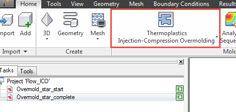

  1. Select Thermoplastics injection compression overmolding as the molding process.

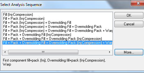

  2. Select the analysis sequence. The first 5 analysis sequences are the original options, but they have been renamed more explicitly to distinguish them from the new analysis sequences. The bottom three new analysis sequences use injection compression molding in the overmolding step.
  3. Continue to follow the instructions in the help.
