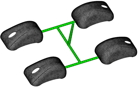

(Home tab > Import panel > Import).Navigate to the location where you saved the tutorial files.
Select the study mousecover_4cavity.sdy and click Open.
