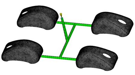

In this tutorial, you set up and run a Filling + Packing analysis on a 4-cavity tool of the computer mouse cover. You evaluate the fill balance between the parts, the pressure to fill the tool, the shrinkage on the part, and the cooling time.
